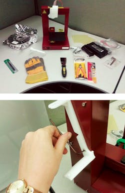

2. Top: The Afinia comes with an array of tools. Bottom: Only the ABS spool holder needs assembly. Attachment with an Allen wrench is quick and easy.
Computer compatibility: The printer works with PCs and Macs. We tested the machine with a Windows 7 PC. However, check with the manufacturer for the graphics card required. One of our computer’s graphics card had too little power to properly display and allow manipulation of the RoboCop Droid model.
Assembly: Comes fully assembled, sans the spool holder. But the spool holder attaches quickly with an Allen wrench (included).
Tools needed: The Afinia ships with everything a designer needs to print and remove support material. We suggest having super glue handy for reattaching any pieces that break off printed parts. Also, as a safety precaution, we wore safety goggles to protect our eyes from bits of plastic that fly off when removing more stubbornly affixed support material with an X-Acto knife (also included).

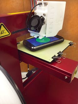

4. We used a smartphone app to get the printer platform level. A level platform prevents the nozzle from scraping and lets the printer make even parts.
• Confirmation of connection: The Afinia H-Series connects to a computer via a USB cord. However, it’s not always obvious when the printer connects successfully. One way to check is to go to 3D Print on the Afinia software’s toolbar and make sure all options are available for use — especially the Maintenance option.
• Leveling the platform: If the platform is not level, the print won’t be even. What’s worse, the nozzle can scratch against an unleveled platform, which puts it at risk for damage. To level the platform, don’t eyeball it. Get a level and use the manual screws at each corner to adjust. We used a smartphone with an app called Bubble Level. Placed it on the platform, it told us when we were on target.
• Setting nozzle height: The nozzle height is the distance between the platform and the nozzle. The desired nozzle height for printing is when the platform sits as close to the nozzle as possible without touching it — about 0.001 in. To move the platform to the fixed nozzle, the user must enter into the Afinia software the desired nozzle height in millimeters. Note that the platform height cannot be manually adjusted.
This step is hard because the software reads the platform at 0.00 mm when the platform is furthest from the nozzle (and not when it’s touching the platform, as one might expect). It’s also hard to physically measure the distance between the nozzle and platform. That forces the user to guestimate the distance and then input small increments until the platform reaches desired height. We used an online reference at machinedesign.com.technologies/3Dprinting to hone in on a nozzle height of 134.4 mm. Tip: Place a sheet of paper between the nozzle and the platform. When it’s hard to move the paper, the nozzle is at an ideal height.
