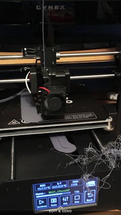

3D printer bed-adhesion failure

However, we soon started to experience failure after failure, with no telltale signs of why they were happening. This is where things began to become frustrating for us. We would try adjusting some settings in hopes that it would fix our problems. The longer that we had these issues, the more frustrated we became. Every time we thought we were making progress and we would have a couple of successful prints in a row, a new issue would arise. These struggles went on for months. After more failed prints than we wanted to count, and one equipment failure, we were finally able to print parts on a fairly consistent basis. We never expected to have so much difficulty getting consistent prints.

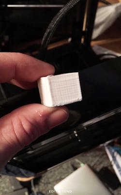

3D printers are able to print at a layer height starting as high as 0.4mm and go as low as 0.1mm or lower. As layer height is lowered, the finer details the print will have, and in theory the better it will look. But this is not always the case. When using a 3D printer, you must experiment and figure out the sweet spot for your specific printer’s layer height.
3D printer issues from poor layer height settings
