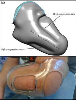

A suggestion I have for a person working on print prostheses is to focus more attention on the sockets. The conventional method for making a socket is to take a cast or digital scan of the patient’s residual limb. Then, modify contours of this model to apply pressures on the soft tissue, and relieve pressure from sensitive areas (i.e., bony prominences, fragile skin, and sensitive nerves (Of course, this description is just an overview. The specific details are complex, and more information can be found here).
In its simplest form, a socket should fit the contours of the body and redirect pressure from sensitive areas, such as bone, to less sensitive areas, such as soft tissue.
One way to make a better-fitting socket is to use flexible materials in this interface like most conventional prostheses do. I am familiar with rigid printable materials like PLA, ABS, and nylon. However, I would not build a socket out of any of these. At Create Prosthetic, we design almost exclusively with flexible material called Flexy Fit.Thermal plastic elastomers (TPUs), such as, Ninjaflex, Filaflex, etc., work well, too. These materials are all urethane-based materials, which are a common material for prosthetic liners and flexible inner sockets. Flexible materials can help dissipate forces on the prosthetic over a larger surface area of the residual limb, making it more comfortable to wear regularly and for longer periods of time.
