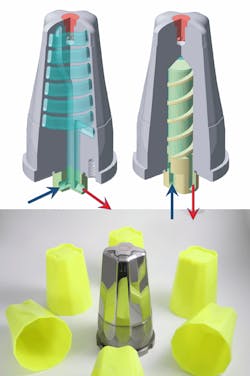

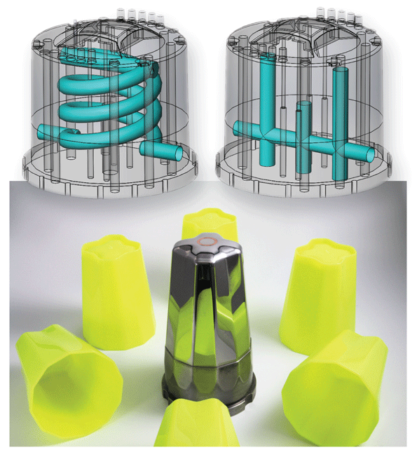

On the left is an example of a 3D-printed metal mold printed with conformal cooling channels. At right are conventionally machined cooling channels in a metal mold.
Direct metal laser sintering (DMLS) is a key technology used to print tool cores (also called mold inserts) for injection-molding processes. DMLS works just as it sounds — a 3D printer grows a part by sintering metal powder layer upon layer with a laser. This process lets engineers optimize the design of cooling channels. Cooling channels can be printed to any shape and closer to the part than subtractive methods can accomplish. The resulting conformal cooling channels save time, cut waste, and improve quality during the production of injected-molded parts.

EOS application engineer Siegfried Mayer further explains why printed metal tool cores top machined tools. He says subtractive methods have several limitations when it comes to optimizing channel cooling. Only straight-line channels can be drilled, a limitation that can widen the distance between the cavity and the cooling channel. The result is an uneven dissipation of heat in the tooling material and uneven temperature levels on the cavity surface. This condition can also create uneven cool-down that cause internal stresses. These stresses can lead to warpage (which leads to higher scrap rate).

A few tips help meet these goals. Mayer explains that cooling-channel cross sections can be designed to almost any shape. Turbulence of the coolant (the desired high Reynolds number) within the system can be controlled by modeling different cross sections. Doing so will create turbulence close to the cavity along the entire path of the channel. A bended path in the design should improve this effect.
Changing the cross section or forking the cooling channel is a trick to help balance the two goals. Forking allows for additional heating and cooling in areas that cannot be reached by conventional methods. This feature actively influences cooling processes inside the melt. Evenly cooling the plastic melt minimizes warping, sink marks, and internal stresses. Mayer adds that the avoidance of internal stresses produces quality parts with the same amount of material, thereby reducing or eliminating scrap rates.
