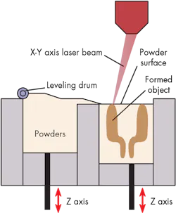

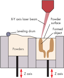

SLS Process
After the part is formed in the powder-bed process, it’s removed and cleaned for any post processing. The powder that’s left un-sintered acts as a support material; after the process, it can be sifted and reused.
In powder-bed SLS, a layer of powdered material is carefully laid down by a leveler or roller on the build tray. A laser then sinters the cross-section of the part. Subsequently, the tray drops another 0.002 to 0.004 in. (0.05 to 0.10 mm) and the process repeats. Similar to SLA, layer thickness varies based on laser strength, material, or tolerance desired.
