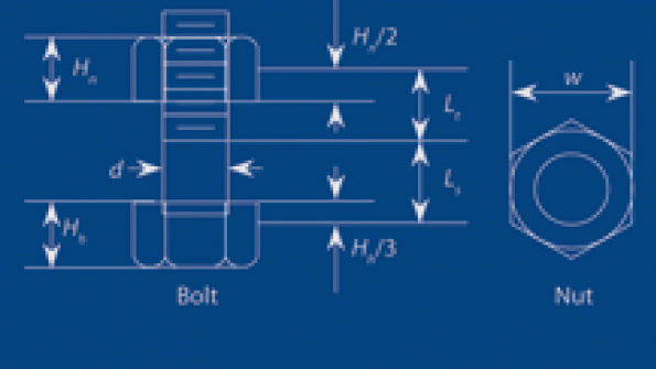

Bolt stiffness
Bolts consist of shank and threaded sections, as shown. Stiffness of the shank is:
where As = πd2/4.
The threaded-section stiffness is:
where At = tensile-stress area of the screw.
The tensile-stress area of the screw can be found in handbooks and textbooks. Or calculate it based on the equation from ASME Standard B1.1-1989 (revision of ANSI B1.1-1982) for unified inch screw threads:
where D = basic major diameter. The basic pitch diameter d2b = D – 0.75 H; H = height of a sharp V-thread or fundamental triangle, H = √3(P/2); and P = thread pitch. 1/P is the number of threads per inch.
Or determine the stress area of the screw based on the area of a circle with the average diameter, da, calculated from the basic pitch diameter, d2b, and minimum minor diameter d1m = D – 1.5 H.
The effective length, Lt, of the threaded section is from the interior end to the midpoint of the nut height. This assumes that bolt tensile force decreases linearly from the seating surface to the free surface of the nut. The effective length of the shank, Ls, includes one-third of the bolt-head height. This assumes bolt force diminishes linearly along the height of the bolt head starting at the mean area of the seating surface. Because the widths across flats of the bolt head are typically w = 1.5d, the mean diameter of stress area in bolt head is dm = (d+w)/2.
Equivalent stiffness of the head in terms of the shank is
For studs with or without threaded inserts, include one-half of the thread-engagement length in the threaded-section length for stiffness calculations. These approximations are judgment calls. Other methods use d/4 in lieu of both Hn/2 and Hh/3. The series spring-connection method may be extended to bolts with multiple diameters.
Calculate total bolt stiffness, kb, from series connection of the section stiffnesses:

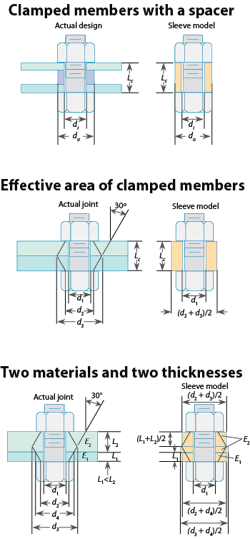

Clamped members Clamped members can be treated as a sleeve. The stress area of the hollow cylinder is:
Ac = π(do2– di2)/4
where do and di = outside and inside diameters, respectively. The clamped-member stiffness is:
kc = AcEc/Lc.
Calculate the clamped member stiffness of a solid structural connection using a double-cone load-path model, as shown in the graphic, “Effective area of clamped members.” A 30° cone angle is customarily used in industry. If clamped members have the same modulus of elasticity, the double cone shown is equivalent to the sleeve model.
The double-cone model can be modified to accommodate clamped members with different moduli of elasticity and thickness as shown in “Two materials and two thicknesses.” The stiffness of clamped members is calculated from series connections of three hollow cylinders shown in the sleeve model, assuming L1.
