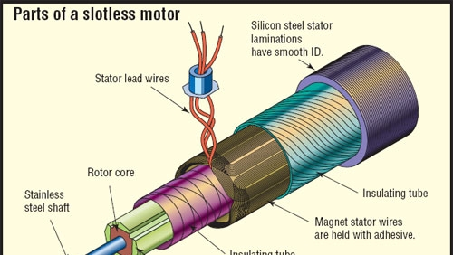

As brushless technology and manufacturing methods have improved, slotless stator designs emerged as a solution to cogging in conventional brushless motors. The slotless stator and refinements to the lamination process are the key to smooth performance. Instead of winding copper wires through slots in a laminated steel stack as in conventional brushless motors, slotless motor wires are wound against silicon-steel laminations. Then they are encapsulated in a high-temperature epoxy resin to maintain their orientation with respect to the stator laminations and housing assembly. This configuration, which replaces the stator teeth, eliminates cogging for smooth, quiet operation.
The slotless design also reduces damping losses related to eddy currents. These currents are weaker in a slotless motor because the distance between the laminated iron and magnets is greater than in a slotted motor. With low damping losses, slotless brushless motors achieve more efficient operation and run cooler.
Slotless motors are typically designed with sinusoidal torque output that produces negligible distortion, rather than a trapezoidal voltage output. The sinusoidal output reduces torque ripple, especially when used with a sinusoidal driver. Because the slotless design has no stator teeth to interact with the permanent magnets, the motor does not generate detent torque. Further, low magnetic saturation lets the motor operate at several times its rated power for short intervals without perceptible torque roll-off at higher power levels.
Slotless construction also significantly reduces inductance to improve current bandwidth for fast response and acceleration. A samarium cobalt rotor usually offers excellent resistance to demagnetization under all operating conditions.
In addition, high-energy rare-earth magnets have allowed designers to relax air gap tolerances, which traditionally dictated that stator teeth be in close proximity to the magnets. Eliminating these teeth and using stronger magnets will maximize the strength of the electromagnetic field for optimum power output.
Rare-earth magnets are ideally suited for the slotless lamination assembly, as they enable a motor design with optimum functional characteristics, including low electrical resistance, low winding inductance, low static friction, and high thermal efficiency.
One of the crucial differences between slotless and slotted designs is the rotor diameter. Slotless motors have a larger rotor diameter for the same outside diameter and generate a higher inertia, as well as accommodating more magnet material. For applications with high-inertia loads, the slotless design offers an advantage. For applications requiring high acceleration of small inertia loads, the slotless motor is not a practical choice because most of the torque would be needed to turn the motor.
