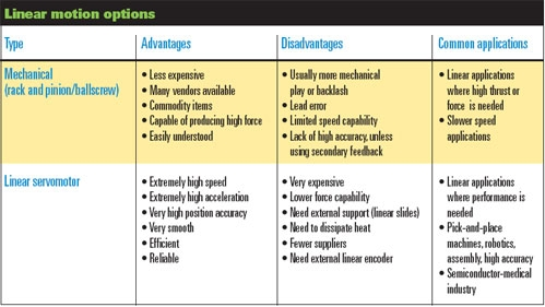

Linear motion
Today’s motor options now include not only rotary choices, but also linear choices. Linear motors are proving useful in many applications because they replace some of the complexity and cost of rotary systems with a direct coupled linear solution. They also allow much stiffer and precise motion (no backlash) and enable faster motions because of low inertia.
Today’s automation systems typically have several linear motion axes. Belts and pulleys provide fairly inexpensive linear motion when coupled with rotary motors, but they can be difficult to control when driving large masses (belts are elastic). Belt drives also lose accuracy over time as belts stretch and pulleys wear.
Ballscrews, on the other hand, provide stable motion and are easy to control. However, they have a limited velocity, especially when longer motion is required. Backlash is also a concern and tends to change as the system ages. Ballscrews are fairly inexpensive if high accuracy isn’t required, but low-backlash ballscrews can be costly.
The latest feed-axis drives are, of course, linear motors, the most common types being iron core and ironless. Iron core motors provide more force per volume, but the amount of force varies as the coil passes the magnets. This type is also somewhat slowed by heavy guidance systems added to withstand the pre-load imposed by the attraction between the iron core and magnets.
Ironless motors, though not as powerful, are capable of much higher accelerations and velocities. That’s because they don’t carry as much mass; their guidance systems needn’t be as heavy because there is no pre-load from the magnetic attraction between the coil and magnet track.
At present, linear motors are limited by the physical constraints of their guidance systems. Although they are typically the most expensive solution, they are cost-competitive with precision ballscrews in shorter lengths, and untouched by belts and ballscrews when a job calls for accuracy and speed over long lengths.
