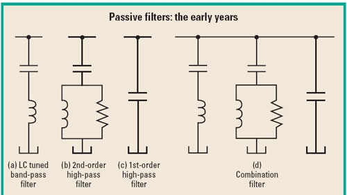

The most common harmonic filter is the passive filter. Passive filters act as harmonic current sinks, shunting the harmonics from the static power converters. However, these devices have some inherent limitations.
The amount of impedance they can compensate depends on the ac source impedance. Usually, this factor is not accurately known, and it varies with the power system configuration. If source impedance is low, passive filters have difficulty providing the required attenuation.
Also, passive filters are sensitive to variations in the supply frequency. This sensitivity affects their ability to compensate the harmonics, especially if the filters are tightly tuned.
Another problem involves a parallel resonant circuit as viewed from the load. Load harmonics may excite this circuit, causing a large current between the source and the passive filter, as well as excessive harmonic voltage across the load.
Likewise, a series resonant circuit as viewed from the ac source can also cause problems. Voltage harmonics from neighboring loads may excite these circuits, forcing a large harmonic current into the passive filter. It may also cause a large voltage across the load, which, together with the current, may blow the passive filter, impair the capacitor, or overheat other electrical equipment.
In addition to all that, passive filters eliminate only selected orders of harmonic current.
