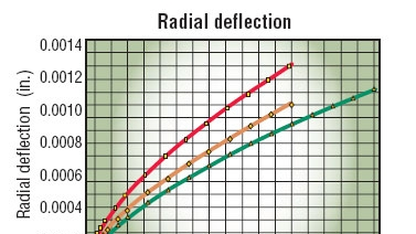

Slewing rings are thin loops: large-diameter bearings with large bores designed to support axial, radial, and tipping force loads. Common applications include cranes, excavators, turnstiles, wind generators, telescopes, and tank turrets. However, slewing bearings are not just for heavy-section, low-precision applications anymore; improved manufacturing methods and design concepts are permitting their use in increasingly small, sophisticated, and precise applications. Both ball and crossed-roller configurations are common. The direction and degree of loading, especially tipping load, mounting arrangements, and performance requirements all determine which design is most appropriate. To combine the function of a bearing and gear, often teeth are cut into the inner or outer race to either rotate with the assembly or remain stationary with respect to ground during operation.
But let’s back up. Why are slewing rings so useful in the first place? The ability to quickly bolt rotating structures to stationary bases is a major design benefit. And in the machine tool industry especially, off-the-shelf availability of highprecision slewing bearings preloaded to eliminate clearance and vibration has become standard. Runout and diameter tolerance increments for these bearings range from thousandths to ten-thousandths of an inch (0.0001 in.) Compact slewing rings offer reduced cross sections and small diameters down to the 50-mm range. (These bearings are smaller than many of the balls used in traditional, heavy-section slewing rings.) This has enabled designers to rethink traditional bearing arrangements.
For example, king-post designs that utilize two (ball or roller) bearings adjusted against one another at assembly can in some cases be replaced by a single bearing. Traditional king-post bearing mounting arrangements used to support radial, thrust, and moment loads consist of two ball or roller bearings spaced along a common axis. Greater moment capacity is obtained by spacing the bearings farther apart, or by using heavier section bearings. However, the space and mounting complications with these arrangements do not lend themselves to all new applications. That’s where slewing-bearing designs come to the rescue. Slewingring rolling elements create a reactive moment within a single bearing’s envelope to oppose the applied overturning moment load. Replacing two bearings with one reduces the height required for an application — and can simplify assembly as well. As a result, slewing bearings are particularly well suited to newer manipulator designs in industrial automation.
