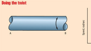

Torsional resonance
Torsional vibration occurs in a drive system when a component operates at its natural frequency or critical speed. Typically, two portions of a rotating component don't maintain the same relative position as the piece rotates. During one revolution of a shaft, for example, a point on the output end may lead and then lag the corresponding point on the input end due to twisting.
All components have torsional resonances, and they can occur at multiples of the critical torsional frequencies. The resultant problems sometimes show up as failed coupling elements, broken shafts, or even broken gear teeth in speed reducers. More often they appear as greatly reduced bearing life because of fatigue forces on the ball or roller cages.
Before selecting a coupling, determine its torsional stiffness, which is usually available from the manufacturer, plus the rotational inertia of the drive components. For an elastomeric coupling, you also need its damping factor. From this data, calculate the drive system's torsional critical frequencies, using an FEA-based simulation software package. Also ask the manufacturer what variations in critical frequency take place with changes in load, temperature, and coupling gap spacing. This type of analysis is particularly important for couplings that are torsionally "soft" because their critical frequencies occur at lower speeds that are likely to fall within the operating range.
Torsional vibration can sometimes be avoided either by shifting the operating speed out of the critical speed range, or by changing the weight and inertia of components to move the critical speed away from the operating speed. In most cases, however, these methods are impractical. Therefore, a different type of coupling is used to move the critical speed out of the operating range.
Flexible couplings offer a wide range of torsional stiffness and damping properties to protect equipment against shock and vibration. For example, elastomeric couplings come in two basic types, compression and shear. Those that use elastomeric elements in compression can transmit high loads, whereas those with elements in shear offer high damping of torsional vibration.
