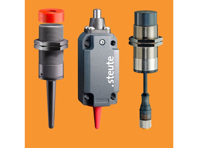

Wireless switches such as those from ZF and Steute contain small transmitters with a nominal range of approximately 1,000 ft. outdoors and 100 ft. indoors. (Local conditions may reduce those ranges, but signal repeaters can solve such problems.) A receiver connects to the system’s controller. Receivers can be PCB modules for direct integration or 32-channel receiver modules with data ports for interface integration, which may be suitable when creating just one or a few systems. There are also USB receiver modules available for prototyping.

In some energy harvesting switches, it takes manual activation or the application of a relatively strong external force to trigger signals. That’s because a Chiclet-sized magneto (magnet and coil) inside has to be physically triggered to generate 330 mW—just enough power to transmit a brief wireless signal. Hand remotes, command switches, foot switches, handle switches, and some pull-wire switches are good implementations of energy harvesting, as are some position and limit switches. Other self-powered switches tap into solar power or rely on rectified RF energy, much like an old crystal radio.
Energy harvesting is not an alternative for wireless switches based on magnetic or inductive sensing; these are also available but require an internal battery for power.
Energy-harvesting wireless switches, such as these from Steute, can be push-button, rotary, or require users to have a key for security. Switches are designed to be independent, and controller programming determines their actual functions.

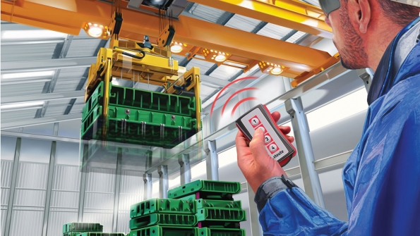

ZF/Steute energy-harvesting controls can combine four switches in one handheld unit.
