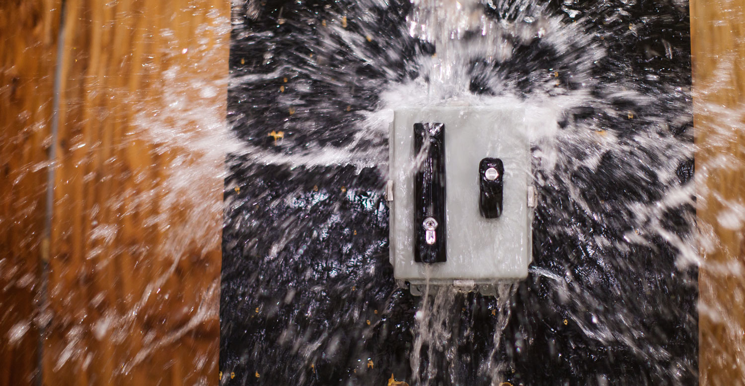

Machinedesign 15871 Promo Sc Fig1

For example: Type 4X rated enclosures are certified for outdoor use, providing an established degree of protection against hose down, splashing water, windblown dust, rain, snow, and sleet. They are constructed of materials and components that remain undamaged by the formation of ice on the enclosure.
So, if all the other Type 4X conditions are met—constructing the enclosure out of materials exempt from corrosion testing such as 304 or 316 stainless steel, using pre-qualified UL approved gaskets to line the enclosure, and choosing accessories with the new FTTA2/FTTA8 recognition—all enclosure manufacturers will need to do is perform a hose down test to document that their enclosure can be Type 4X rated by UL. By pre-qualifying the enclosure for outdoor applications, it’s been estimated the manufacturer will save at least 50 days of testing time as well as the cost of test samples.
