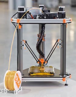

In response, the e-commerce sale house Monoprice Inc., Rancho Cucamonga, Calif., offers super-cheap filament for other companies’ printers as well as its new $1,199 dual-color extrusion 3D printer — with the likably straightforward Product ID #11614. (The machine uses the company’s standard 1-kg, 1.75-mm filament spool and can print with ABS, PLA or PVA plastic.)  ABS and PLA filament colors through monoprice.com include fluorescent yellow, crystal clear, bright orange, bright green, blue, red, purple, white and black.
Some users suggest that the filament has slightly lower consistency in color, melting temperature, and diameter than full “brandname” filament from Octave or Afinia. But the price — 1-kg spools for $34 — is hard to beat.
