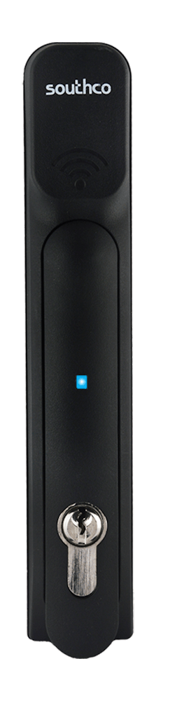

Southco’s H3-EM Electronic Locking Swinghandle with RFID Reader, can be easily installed within an existing cabinet and added into a building’s overall security infrastructure. The person managing security can then control access on an individual basis, ensuring only authorized personnel gain access to secure enclosures.
