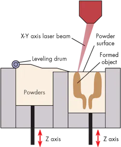

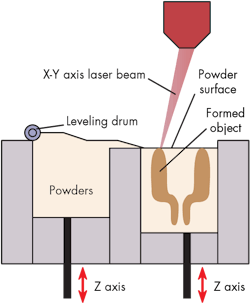

4. Selective laser sintering: after the part is formed in the powder-bed process, it’s removed and cleaned for post-processing. The powder that’s un-sintered acts as a support material. After the process, it can be sifted and mixed with virgin material to be reused.

SLS is also commonly associated with the powder-bed process. This process uses a bed of powdered material (polymer or metal). A high-powered laser generates one layer of a part each pass, normally around 3.94 × 104 in. (10 µm) layers thick, and an industry-standard tolerance of 0.004 in. (0.1 mm). These can be altered by the laser’s properties, and material used in the process.
