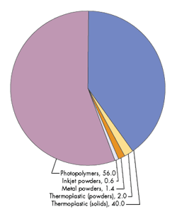

Created in 2013, this chart shows the breakdown of different materials and why there may be so much focus on processes like stereolithography (SLA) and fused filament fabrication (FFF) that use photopolymers and thermoplastics.
Photopolymers
With new processes like digital light projection, and recently, Carbon 3D’s way of processing parts at greater speeds, photosensitive polymers may quickly gain more popularity. In 2013 they were already over half the 3D printing material’s market. Photosensitive polymers are liquid plastics that solidify in ultraviolet (UV) light. Often used in stereolithography (SLA) and jetting processes, the materials are generally good for form, fit, feel, and looks.
