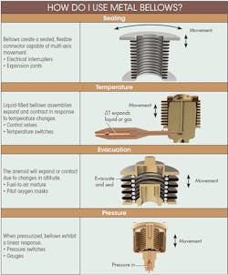

Bellows are a versatile component, having the characteristics of both a piston and spring. They are used in dozens of different sensing, fluid handling, and actuation applications. In general, these applications fall into four broad categories—sealing, temperature, evacuation, and pressure, otherwise referred to as “STEP.”
The versatility of bellows, however, also creates some design challenges. Bellows behave differently, depending on how you load them. Like a spring, bellows exhibit hysteresis and linearity effects that must be considered in any design. A given bellow, for example, can have one set of lifecycle, pressure, and stroke characteristics when compressed under an axial load, and an entirely different set when expanded with an internal pressure.

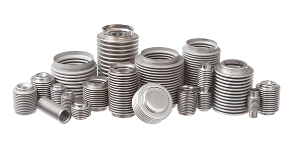

Manufacturing Methods
With metal bellows, you cannot begin to talk about performance without considering the manufacturing method. All of the key performance parameters we just reviewed depend heavily on the way the bellows is formed or welded.
Seamless hydroformed bellows
As their name suggests, seamless metal bellows have no welded joints. Instead, they are produced in a multi-step, deep-drawing process. A secondary hydroforming step forms the convolutions. The deep-drawing and hydroforming processes can hold extremely consistent dimensional tolerances. For example, wall-thickness variation from a well-controlled deep-drawing process is typically within ±0.0001 inches.
This dimensional consistency translates directly to a tight spring-rate tolerance, and a precise response to applied forces and pressure. In addition, because they’re drawn and formed, seamless bellows avoid the potential leak paths and internal stresses of welded joints. Seamless production methods also allow the bellows to be closed at one end, making it possible to integrate connection points or other design features.
Because they are drawn and formed, seamless bellows avoid the potential leak paths and internal stresses of welded joints. Seamless production methods also allow the bellows to be closed at one end, allowing the integration of connection points or other design features.
Seamless bellows do have some package size limitations. Their sweet spot for OD lies between 0.25 to 3 inches. Seamless bellows also have a higher initial tooling cost than seam-welded bellows. At high production volumes, though, the tooling costs of bellows is low enough to be considered negligible.
For high-volume applications requiring a small package size and a precise spring rate, seamless bellows are by far the most popular choice. These applications include many kinds of appliances, HVAC, and industrial controls and sensors. Some examples are thermostats, oven and refrigeration controls, gas valves for boilers, and pressure and temperature gauges.
