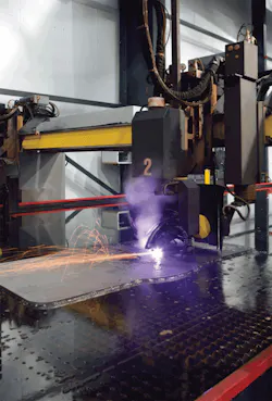

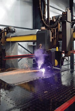

• Help attain accuracy within a few ten-thousandths of an inch on plasma-cutting machines, thanks to exceptionally low backlash. Helical crowned gearing provides fast positioning and smooth movement, and sealed gearboxes keep out abrasive dust generated during cutting.

Helical-crowned planetary gearheads provide smooth motion with low backlash, letting plasma-cutting machines maintain accuracy within a few ten-thousandths of an inch.
