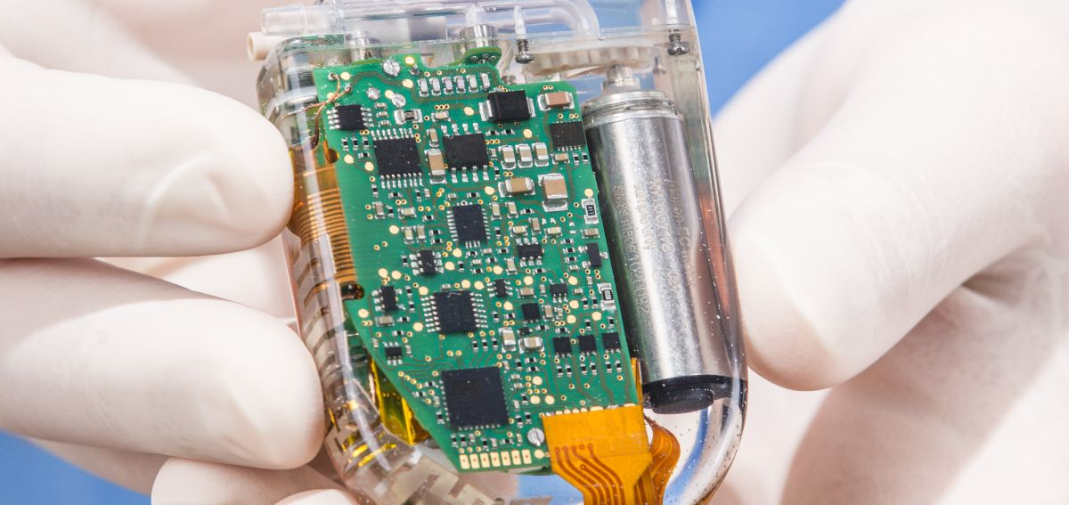

To control fluid that has collected in a patient’s abdomen, Sequana Medical has developed an active implant. In these devices, maxon EC motors are responsible for trouble-free running and smooth pump motion. (Copyright Sequana Medical)
