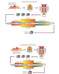

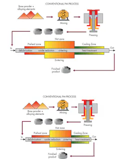

The powder-metallurgy (PM) process, depicted in the diagram below, involves mixing elemental or alloy powders, compacting the mixture in a die, and then sintering, or heating, the resultant shapes in an atmosphere-controlled furnace to metallurgically bond the particles.
Most powder-metallurgy parts weigh less than 5 lb. (2.27 kg), although parts weighing as much as 35 lb. (15.89 kg) can be fabricated in conventional PM equipment. While many of the early PM parts, such as bushings and bearings, were very simple shapes, today's sophisticated PM process produces components with complex contours and multiple levels, and does so quite economically.
