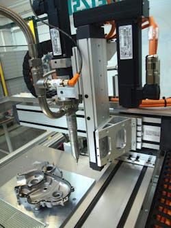

This Cartesian robot consists of basic system building blocks that were customized later. With such designs, OEMs can design controls and mechanical components separately and then tie them together with custom code for a timer to trigger a pick-and-place motion.

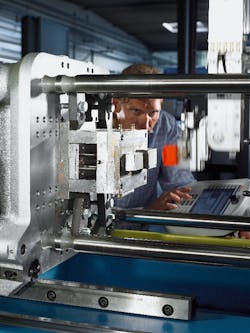

This Cartesian robot is just as reliable as SCARAs and articulating robots, which have set parameters and directions of movement. In contrast, Cartesian robots are reconfigurable so manufacturers don’t have to buy new equipment when designs change.
