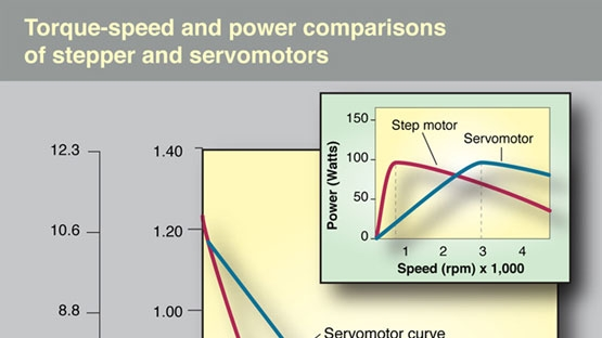

Stepping motors compete with small servomotors: A typical stepper’s continuous and peak torques are equal; torque declines from stall value to as much as 50% at 1,000 rpm; no tuning is necessary with an open-loop stepper. In contrast, a typical servomotor’s peak torques vary by up to three to four times continuous; torque is relatively flat until the voltage limit of the drive is reached; tuning is necessary.
Choosing between steppers and servos first depends on the application torque-speed requirement, preferably delivered at maximum efficiency. Consider that a 100-W stepper’s power peaks at about 800 rpm; a 100-W servo’s power peaks at 3,000 rpm. The stepper is designed to provide maximum power at low rpm, and the servo delivers maximum power at higher speeds.
