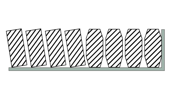

Traditional Means of Reducing Cogging
Cogging is not unique to linear motors; rotary motors have the same problem. There are several methods traditionally used to minimize cogging that can be employed in linear motors. These include:
  • Skewing the magnets;
  • Shaping the magnets; and/or
  • Skewing the slots in the laminations.
All of these reduce cogging by intentionally misaligning the laminations and magnets. This softens the transitions of the lamination teeth from one magnet to the next and reduces cogging, but it also reduces the motor’s force output and efficiency because the windings and magnetic fields are no longer optimally aligned.
4. Skewed and Shaped Magnets: Intentionally misaligning laminations and magnets reduces cogging, but anti-cog technology uses destructive interference to accomplish the same effect.
