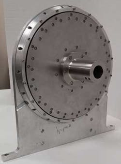

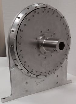

Toliyat’s group has worked on three basic configurations of magnetic-gear designs: an axial gear, a radial gear, and a trans-rotary gear. Axial designs have a configuration resembling that of a clutch pack or pancake motor. They consist of two disks each containing alternating positive and negative magnets with a modulator disk in between. The low-speed disk, or low-speed rotor, contains a magnetic pattern geometry that alternates more quickly than that of the high-speed rotor. Thus there are more pole pairs on the low-speed rotor than on the high-speed rotor. The gear ratio is a function of the number of pairs on the two rotors and the air-gap fluxes they produce. The amount of torque transmitted is a function of the flux linkages between the two disks and is affected by the size of their magnets. So as the size of the magnetic areas grows smaller — as when cramming in more pole pairs or reducing the diameter of the rotors — there is a point of diminishing returns as radial-flux leakage becomes more of a problem.

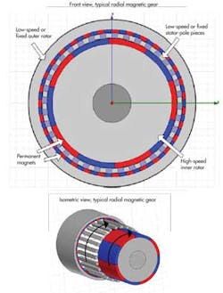

Radial magnetic gears have a configuration that resembles that of a synchronous motor. A typical topology uses a high-speed inner rotor concentric with a low-speed outer rotor. The two rotors are separated by a stator typically composed of electrical steel bars. As with axial magnetic gears, the stator bars modulate the flux between the permanent magnets on the input and output rotors.
Axial magnetic gears are probably the most challenging basic topology, say researchers in Toliyat’s group. “There can be huge axial forces on the bearings so there are a lot of issues,” explain Texas A&M Ph.D. students Matt Johnson and Siavash Pakdelian. They also say axial designs are tougher to analyze than those of other configurations because an accurate analysis requires a full 3D model whereas other topologies can be simplified for analysis using symmetry. And as currently constructed, axial designs would be more difficult to manufacture than magnetic gears using radial or trans-rotary configurations.
Manufacturing considerations are among the reasons why industry seems to have more initial interest in building radial magnetic gear designs than axial designs. Radial magnetic gears have a configuration that resembles that of a synchronous motor. A typical topology uses a high-speed inner rotor concentric with a low-speed outer rotor. The two rotors are separated by a stator typically composed of electrical steel bars. As with axial magnetic gears, the stator bars modulate the flux between the permanent magnets on the input and output rotors.
Radial and axial magnetic gearbox prototypes from the Texas A

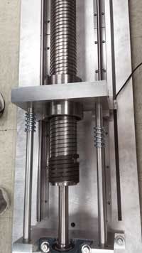

It also looks as though trans-rotary designs are a promising technology. These operate in a way analogous to magnetic versions of mechanical ball screws, converting linear motion to rotational motion and vice-versa through use of a shaft containing magnets oriented in a helical pattern like that of screw threads.  A trans-rotary design can provide gearing action at the same time. In practical applications it can convert the low-speed, high-force linear motion of a translator (screw shaft) to the low-torque, high-speed rotation of a rotor (ball-screw nut). Both rotor and translator are typically made of ferromagnetic iron cores that are lined with alternating magnetic poles arranged in helical patterns. The magnetic helixes on both the rotor and translator have the same pitch. The gear ratio is the ratio of the rotor angular speed to the translator linear speed, which is affected by the number of poles and the pitch of each helical magnet arrangement. To boost the gear ratio, designers reduce the number of poles and make the magnets narrower. The number of poles is analogous to the number of starts in a mechanical threaded rod, and the product of the number of pole pairs and their width is analogous to the lead of a mechanical leadscrew system.
A trans-rotary magnetic gearbox prototype developed at the Texas A
Toliyat’s group has prototyped all three gearing configurations, with the trans-rotary version being the largest scale of the lot. “Applications that capture energy from waves would benefit from the trans-rotary design,” says Texas A&M’s Pakdelian. “To capture reciprocating motion at low speed and high force, your alternatives are hydraulics — which are low efficiency and high maintenance — or, more likely, direct-drive linear machines. These are bulky, costly, and heavy. We can show that trans-rotary magnetics use much less raw material than direct-drive linear machines.”
Pakdelian says the group has built trans-rotary prototypes using magnets about 8 mm wide with a 10-mm pitch. Their prototype using this pitch configuration can convert a linear speed of 1 m/sec to a rotational velocity of 3,000 rpm. “If you want a lower pitch, you have to paste in more magnets. That makes fabrication more difficult in a laboratory setting, but it should be less of a problem if they are assembled on a production line,” says Pakdelian.
