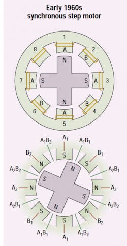

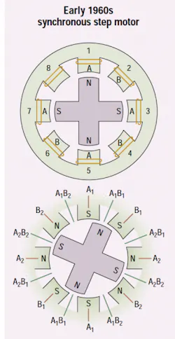

In 1960, the large-angle type PM step motor was the most used step motor. This two-phase, bifilar wound PM step motor (top) advanced 45° mechanical with each pulse from the drive, while by 1962 PM step motor drives (below) were using halfstep 22.5° mechanical excitation strategies to try to smooth motion.

The first step motor, a bidirectional variable reluctance type, was developed for the British Navy in 1933. It was used as a remote position repeater for a compass and gun pointer direction indicator. The drive was crude but effective for these slow constant speed applications. The system was later adopted by the U.S. Navy during World War II. The step motor was used in a limited number of primitive digital control systems through the 1950s. The predominance of closed-loop continuous ac induction servos from 1944 to 1957 was soon overcome by the PM step motor and the availability of digital measuring devices and control logic necessary for all-digital systems.
The 1961 hybrid step motor’s rotor cups each have 50 fine teeth indexed one rotor tooth pitch. Alternating north and south poles assures proper magnetic link with the stator windings, producing high torque and 1.8° mechanical step motion.

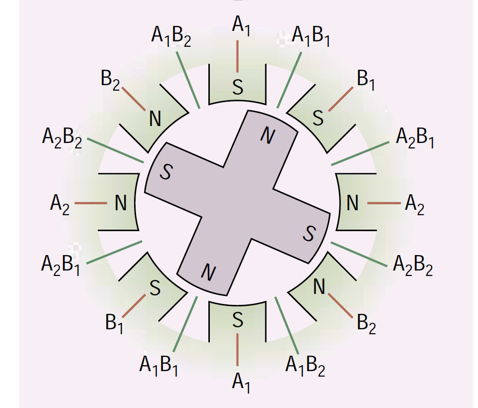

By 1960, the PM step motor (large-angle type) had become the primary step motor in use. There were no cures for resonance or shaft velocity vibration other than stop the step motor shaft and restart the motion. The key attributes were the PM step motor’s open loop position accuracy of +5% and the non-cumulation of position error. The brush servo (closed-loop) system or small instrument ac (two-phase) servomotor system required careful stabilization of the analog feedback signals (velocity and position). It was a daunting task to close a servo loop and properly stabilize the servo motor in 1960. Typical step motor applications in 1960 included drone control readouts, railway car sorting indicators, portable weighing station indicators, and digital differential altimeters.

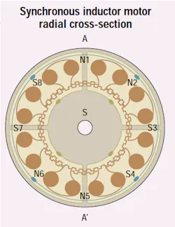

The ac synchronous inductor motor
A few years previously, General Electric had developed an ac synchronous inductor motor for use in low-speed smooth motion applications. This motor was designed to operate with a 60-Hz, 115-Vac signal and generate smooth continuous motion equivalent to the movement of an analog clock’s second hand. In 1961, Snowden and Madsen of Superior Electric Co. announced a new rendition of the synchronous inductor motor which would become famous by another name, the hybrid step motor.
Within two years hybrid step motor sales eclipsed that of ac synchronous inductor motors. The hybrid step motor drive scheme in 1961 also used a bifilar winding driving the two-phase winding halves A1, A2, B1, B2. The power supply current was in a single direction or in a unipolar excitation scheme. Unipolar-based drive circuits remained popular throughout the 1960s and 1970s.
In 1970, Siemens introduced the first commercial brushless dc motor, which had an integral tachometer and shaft position sensor. The two drive methods for two-phase brushless motors relate to the step motor’s unipolar (star) and bipolar (bridge) drive circuits.
The Snowden-Madsen paper also displayed another basic drive scheme; A, A-, B, B-, which represents the bipolar drive scheme. Two power supplies are needed to support a bipolar (bidirectional current) drive scheme. While not popular in the 1960s and 1970s, the bipolar drive is the most popular drive scheme today. One of the first applications for the hybrid step motor came from the factory automation market. When this step motor was mechanically coupled to a five-pitch lead screw, the combination provided a step-by-step motion of 0.001 in. This step increment worked very well with tables on machine tools, laboratory, and business machines. Superior Electric was the pioneer of the hybrid step motor under the SLOSYN brand name to be joined by others by the late 1960s.
