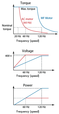

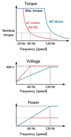

For a common four-pole, three-phase ac motor, 120 Hz is the ideal operating frequency for the best mix of high output power, dynamic response, wide speed range, and a high level of efficiency. Multiple frequency motors also provide a wide speed range and a high degree of efficiency while reducing cost and energy usage. Many 120-Hz, multi-frequency, three-phase ac motors were developed with these goals in mind.

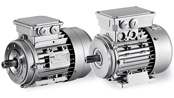

In Lenze’s motors, electrical windings are optimized to a rated frequency of 120 Hz, with a rated voltage of around 380 V ac for global flexibility and a rated speed of 3,500 rpm. These attributes increase both dynamic performance and productivity. Compact and highly efficient, these motors can be paired with a 96% efficient, two-stage bevel gearbox with a lightweight, aluminum housing and precision-honed, wear-free gear teeth.
For variable-speed applications, compact, 120-Hz, multi-frequency ac motors provide even more value, including space savings. Designed for tasks requiring variable setting ranges with minimal sizes, these 120-Hz geared motors exceed efficiency-class IE2 motors while delivering speed ranges of 24:1. By contrast, conventional motors offer adjustment ranges of only 3:1. Because these 120-Hz motors feature speed ranges much wider than those of conventional motors, they can be used on applications that require slow and fast speeds from a single motor, with constant torque throughout the setting range.
Ultimately, users look for reliability and availability. In automated warehouses, for example, high throughput, packing density, and energy efficiency minimize costs and increase flexibility. It’s possible for a single 120-Hz motor to provide all these benefits while serving a variety of applications. These compact, three-phase motors, for instance, enable energy-efficient drive solutions without costly design alterations.
A frequency-optimized induction motor provides continuous torque over a wider range of speed than standard motors.
Inverter-optimized, asynchronous versions of 120-Hz multi-frequency motors can be up to two frame sizes smaller than conventional IE2 motors while offering the same performance. In addition, because the motor is smaller, the rotor inertia is lower than standard ac motors. This results in short dynamic-response times, letting the motor go from 0 to 3,500 rpm in 500 msec.
