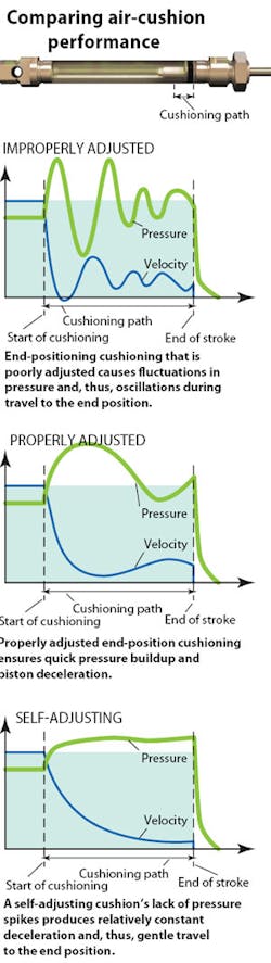

Air cushions are variable-orifice air dashpots. As the cylinder cycles, a spud on either side of the piston closes a passage to the main piston chamber. This traps air in the cylinder end cap and bleeds it off through a small port controlled by a needle valve. The cylinder traps a fixed volume of air each cycle. But because air is compressible, the load, velocity, and pressure in the cylinder all affect air-cushion performance.
For any given set of conditions, there is generally only a small window of needle-valve adjustments that provide acceptable cushioning. Closing the needle valve too far results in high initial reaction forces, which slow the load too quickly. It can also cause end-of-stroke bounce: the piston oscillates as it decelerates, causing vibration and extending cycle time.
Open the needle valve too far, however, and the trapped air does not generate sufficient back pressure. The load reaches the end of stroke too quickly and the piston hits the end cap. And as mentioned above, once the needle valve is properly set, any change in weight, pressure, or velocity affects cushion reaction and means the valve must be readjusted.

And the reality is, different people set the valves differently. That often means actuators are less-than-perfectly adjusted. Underdamping results in higher end-position impacts, more noise, and increased wear; overdamping results in longer machine cycle times.

Self-adjusting cushions create controlled back-pressure near the end of stroke by venting air through longitudinal slots in the cushion spud. Because the slots vary in length, the total throttle cross-sectional area decreases along the length of the cushioning piston. Cushioning begins when the throttle area at the cushioning piston is smaller than the throttle area at the speed-control valve. In essence, that means the effective cushioning length depends on cylinder speed. Higher speed means more kinetic energy which requires a longer cushioning length.
The throttle cross section at the cushion’s leading edge defines the maximum allowable cylinder speed, so it’s made as large as possible. Because cushioning pistons are rather thin, rectangular cross sections are used. They provide ample volume with a small depth.
The throttle cross section at the opposite end defines the minimum allowable speed where cushioning still takes place. This throttle cross section must be as small as possible. V-shape cross sections work best here.
