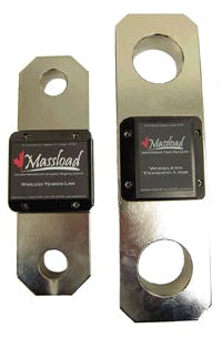

Tension links: Tension links, also called a tension cells, consist of two steel padeyes and a center body housing the load cell. They measure the force in cables, chains, and pulleys, and are most common in lifting, pulling, and winching applications on cranes and wire tensioners on safety cages used in mines. Standard tension links measure 25,000 to 100,000 lb, though custom versions can measure more.
