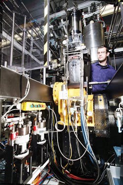

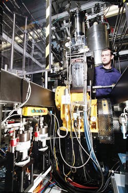

The diesel-engine test bed at Sandia National Laboratory’s Combustion Research Facility is used to study ultrahigh fuel-injection pressures. Two pumps are on the left and the yellow housing contains the crankshaft. Directly above it, the injector and valves mount to the black housing that holds the cylinder and combustion chamber.

To simulate a heavy-duty diesel engine, CRF uses a diesel engine with a single, large-bore cylinder that is fed fuel from two diaphragm pumps at pressures up to 43,000 psi. Inside each pump, fuel and oil, separated by a stainless-steel diaphragm, are pressurized by a hydraulic cylinder. The cylinder compresses the oil, flexing the diaphragm and causing fuel to flow. The dual pumps cycle at 2 Hz, acting 180° out of phase to maintain a set pressure while minimizing pressure spikes. A 6-gpm pump driven by a 10-hp motor supplies the hydraulic fluid.
