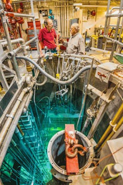

Dick Coats (right), chief technology officer at Eden Radioisotopes and a retired Sandia Lab researcher, talks with John Ford, a Sandia nuclear engineers, in the Annular Core Research Reactor where the two helped develop the type of reactor Eden will build to produce molybdenum-99. (Photo by Randy Montoya)
