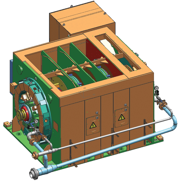

This schematic shows a 12-MW, 9,500-rpm induction motor with oil-film bearings that drives an oil-pipeline pump. Like other high-speed machines, it has a specialty rotor, reinforced bearing housing, and a stator structure engineered to transmit forces away from the bearings.
High-speed rotating shafts present challenges for engineers, particularly in heavy equipment that draws many megawatts of power. Examples include pumps and compressors for oil-and-gas operations, industrial spindles, and aerospace subsystems. Such machines, which can have shafts that weigh several tons and run at 10,000 rpm or more, are prone to extreme vibrations, excessive heat, and catastrophic failure should any mechanical parts go too far out of alignment.
One option is to eschew the turbines that traditionally power such applications and instead use electric motors paired with variable-frequency drives (VFDs). That’s because some motor-driven setups can reliably deliver power to 15 MW under precise control, with smoother operation and higher efficiency than turbine alternatives. Moreover, they perform particularly well when they incorporate active magnetic bearings (AMBs).

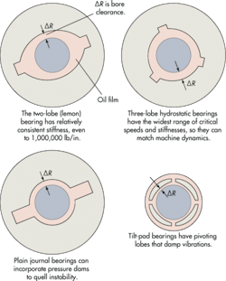

To this end, high-speed heavy equipment driven by motors often incorporates hydrodynamic fluid-film bearings. A thin lubricating oil film separates a rotating journal and Babbitt layer to prevent metal-to-metal contact. The thickness of the lubricating oil film depends on the geometrical dimensions, radial clearances, speed of rotation, and oil viscosity. The catch: These bearings only satisfy dynamic rotor criteria for specific speed ranges.
These two, three, and four-lobe hydrodynamic bearings reduce but don’t completely isolate vibrations at specific loads and speeds.
The two types of hydrodynamic fluid-film bearings include fixed-geometry designs (including cylindrical, two lobe, three lobe, and four lobe) and adjustable-geometry designs (including tilt-pad bearings). Lobe designs have protrusions on the rotating shaft surface that induce preloads in the oil film. The number and geometry of the lobes affects the bearing stiffness and damping qualities — along with critical-speed modes. But hydrodynamic bearings suffer from fluid-film instabilities at high circumferential speeds when lightly loaded. In contrast, tilt-pad bearings work through journal pads that pivot independently, for shapeable oil-pressure profiles. This, in turn, reduces cross-coupled stiffness responsible for out-of-phase force transmission, oil whirl, and instability.

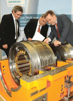

This is a magnetic bearing at a facility founded by Siemens with Zittau/Görlitz University of Applied Sciences and sponsored by bearing-maker Schaeffler Technologies GmbH
For the latter, backup bearings are either rolling or plain. Plain are most common, but rolling bearings (originally based on those for precision spindles) can support shafts many inches in diameter and keep working even after shafts crash into them. Unlike plain bearings, rolling bearings also wear less. And in emergencies (should the magnetic bearing fail), they can temporarily support the shaft at reduced speed. In contrast, some plain bearings for backup need replacement after just one or two shaft crashes.
