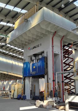

In China, a 3,000-ton automotive body panel press (Fig. 2) failed to reliably keep the platen level during a compression cycle. In Indiana, a vehicle roof-crush test system (Fig. 3) needed to exert a precisely executed and documented amount of force up to 100 tons on a vehicle roof as large as that of a school bus in order to meet industry safety specifications.
2. The platen in the automotive panel press must remain level even as up to 3,000 tons of force are being applied.

To improve the reliability of the log lifting operation, the sawmill managers upgraded the motion control system operating the arms. To fix the potential platen skewing problem, the automotive press manufacturer added cushioning cylinders at the four corners of the platen to ensure that it remained level during a compression stroke. And to control the vehicle roof crush test system, the design engineers in that company set up a test rig with four hydraulic cylinders working together to apply a tightly controlled amount of force.

5. Each leveling cylinder is instrumented with a linear magnetostrictive displacement transducer (LMDT) to provide position feedback. Pressure sensors in the cylinders mounted on each side of the piston produce data which are differentiated to provide force feedback.
Figure 5 shows the hydraulic system block diagram for the four platen-leveling cylinders in the automotive panel press. The transducer and valve connections to the motion controller are clearly visible.

The motion controller in the automotive panel press performs its control functions using a “cascaded-loop” architecture. An inner control loop works to level the platen, while the outer loop simultaneously adjusts the target positions of the cushion (leveling) cylinders to follow the motion of the platen. The outer control loop also monitors the force exerted by the cushioning cylinders to make sure that it remains under the limit provided by a supervisory PLC. If the cumulative force is too high, the motion controller will change the position of the platen to maintain the force below the set limit.
6. Cascaded control loop diagram showing how the motion controller in the automotive panel press works to keep the platen level while it follows the motion of the platen and monitors the force exerted.
The cascaded control architecture is shown in Fig. 6. To level the platen, the motion controller computes the average position of the cushion cylinders, which it treats as a virtual master axis position, and works to move each cylinder position to match this average. To calculate the force being applied by each cushion cylinder, the motion controller computes the difference between the hydraulic fluid pressure on each side of the piston.

Both the automotive panel press and the vehicle roof crush test application take advantage of the motion controller’s ability to control based on force, as well as position, and to smoothly transition between the two. The outer loop of the press starts in position control, monitors the total force applied by the main cylinders, and transitions to force control when the force reaches a certain value—all while the inner loops are controlling position.
