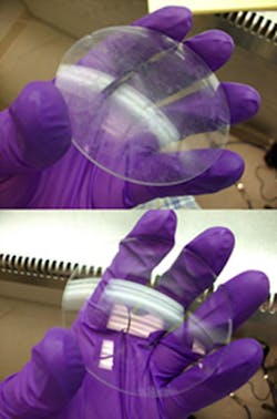

Similar to pretreatment plastics cleaning, CO₂ cleans optic lenses of water spots and light particulate without damaging the surface. Other industries include, but not limited to electronics, semiconductor, medical, and aerospace.

LCO₂ can also be used to clean materials by extracting unwanted compounds (such as unreacted silicone oils) with minimal damage or denaturing. The biggest advantage of LCO₂ is its low levels of toxicity. LCO₂ cleaning works well on medical implants, catheters, silicone tubing, and silicone disks to outgas. Compared to expensive vacuum bake out systems, LCO₂ takes significantly less time (1 to 6 hours, compared to 24 to 72 hours).
