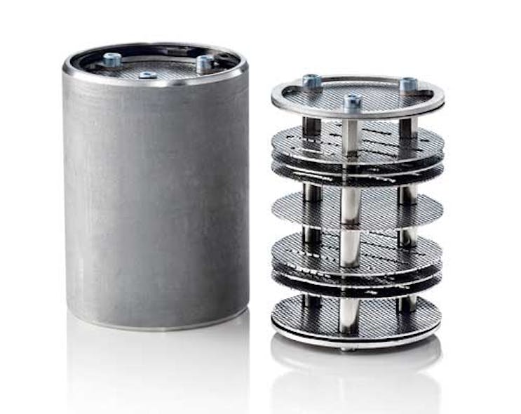

Over three R&D stages, Dexwet Filters developed their aluminum particle filter technology from APF1 to APF2 and the final industry solution SUPER-APF, which has been awarded OEM (Original Equipment Manufacturer) Part status for the technology leading vacuum system supplier Pfeiffer Vacuum.
Dexwet SUPER-APF vacuum filters are permanent filters, with a stable filter inlet consisting of nine filter layers with a sophisticated and patented design. The first two APF versions allowed permanent operation of the die casting unit for 2-3 days without machine downtime, and the third and current version using Dexwet SUPER-APF filters nearly doubled its effectiveness.
Dexwet SUPER-APF normally gets exchanged once per week in the service shift and a maximum of one filter exchange during the week. Such preventive filter exchange is mandatorily dictated by the vacuum system itself and not by any general work direction, as standard nowadays, because such rules cannot take into account the specific conditions and emission behavior of each die casting unit.

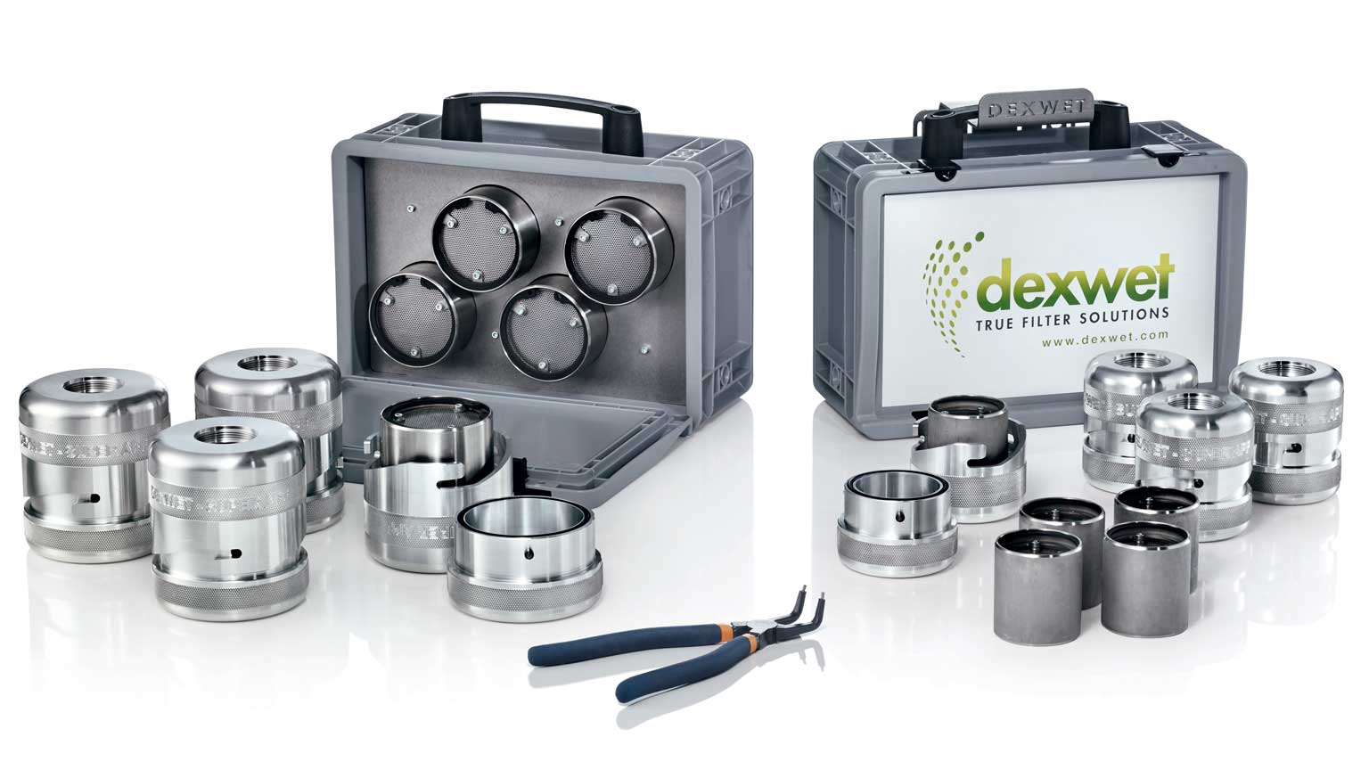

One set of replacement filters is always provided in a transport box directly at the die casting unit for easy and swift filter exchange. In case the vacuum system gives an alarm for preventive filter exchange, the machinist can easily replace all filter cartridges with machine downtime within 5-15 min. The clean filters are taken from the box and the dirty ones are put back into the box.
This short downtime of less than 15 minutes avoids warming shots. And the die casting unit can immediately resume production of good parts. This eliminates the necessity for warming shots and scraps due to vacuum filter exchanges during the whole shift week. At the end of the shift, in case there was a filter exchange alarm, the worker takes the transport box with the dirty filters back to the cleaning station, where a designated box with clean filters is always provided, and should be brought back to the mount at die casting unit for the next exchange.
