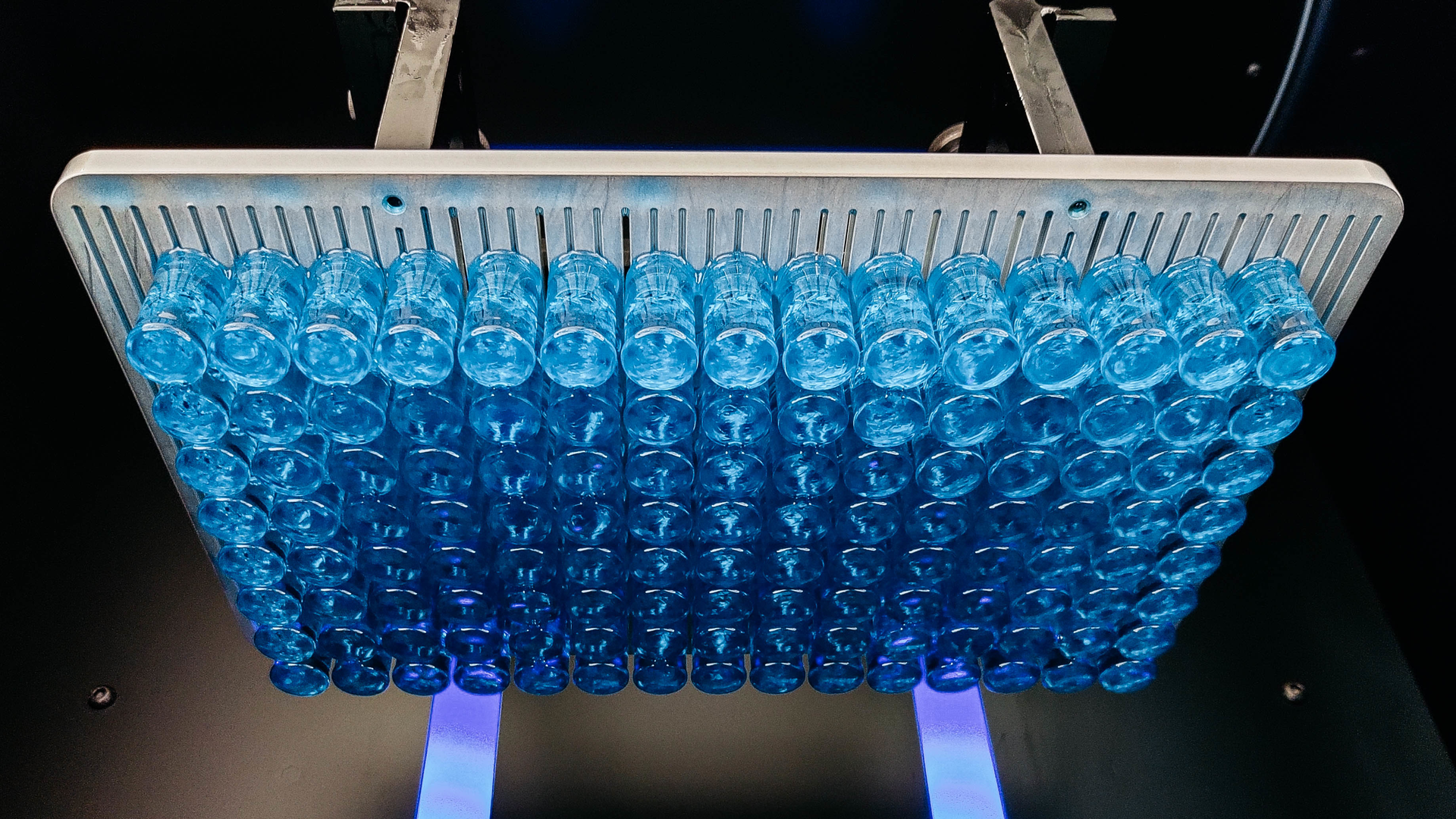

One of the significant advantages of 3D printing lies in its ability to minimize waste and reduce material consumption. Traditional manufacturing processes often entail building multiple tools, which results in significant material and cost investments. Mason says that 3D printing allows for iterative testing and design modifications without the need for extensive tooling.
He notes that by using a digital workflow and 3D printing, designs can be created and tested with minimal material consumption, avoiding the need for expensive traditional tooling workflows. The digital workflow also allows for easy exploration of alternative materials, which promotes lower carbon footprints and better circularity.
WATCH: Is Free-Form Injection Molding Sustainable?
Reduce Carbon Footprint, Move Toward Circular Economy
3D printing enables manufacturers to work with a range of materials, including bio-based or those with circular potential, Mason says. In traditional manufacturing, changing the mold or tooling for different materials would be required, but with 3D printing they can test and compare multiple materials by adjusting the digital model. This flexibility promotes sustainability by reducing waste and empowering companies to make informed choices regarding material selection, Mason notes.
By replacing conventional pilot tooling with free-form injection molding, Staal says they can reduce emissions by as much as 75%, noting a third-party study by Deloitte. More efficient iterations avoid the need for wasteful practices, leading to energy, materials and cost savings.
This technology also impacts spare parts manufacturing. In industries where on-demand batches of one are required for spare parts, it is important to have a manufacturing system that allows for consistent production in the same material and process as the original part. With free-from injection molding, spare parts can be made using the same material and process, extending the lifetime of products while reducing costs and risks.
