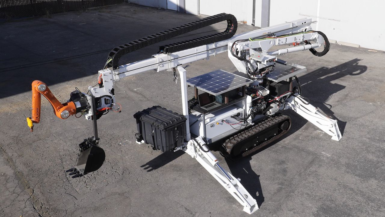

Researchers at Massachusetts Institute of Technology’s Media Lab have built a prototype of a 3D printer large enough to build a 12-ft.-tall dome that is 50 ft. in diameter and fast enough that it did it in 12 hours. The printer is mounted on a tracked platform, so it can move around and be repositioned while it builds a structure, so there are no traditional limitations on build size or build envelope. The tracks lets the printer  transport itself to remote and isolated areas across rough roads, much like a tracked military tank gets around.
The “printer,” known as the Digital Construction Platform, consists of a large robotic hydraulic arm fitted to a converted truck. At the end of the hydraulic arm is a smaller robotic arm—maybe finger is a better term—powered by photovoltaic cells. The smaller arm gives the device more agility and dexterity for creating structural details.
The device can vary the density of the material it is applying, letting it build tapered walls or an overhang, all to standards of building codes. The device can also mix materials, such as soil for building a compressed-earth structure, or concrete for building more conventional structures. The finger can be removed and replaced with other tools to support activities such as excavation or milling.
Researchers at MIT enlarged the standard 3D printer, let it work with a variety of construction materials, mounted it on a tracked platform, and dubbed it the Digital Construction Platform.
