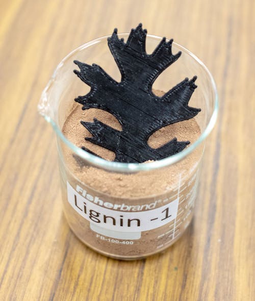

A new composite material created at ORNL uses as much as 50% lignin, a biofuel byproduct by weight, and is well-suited for use in 3D printing.
