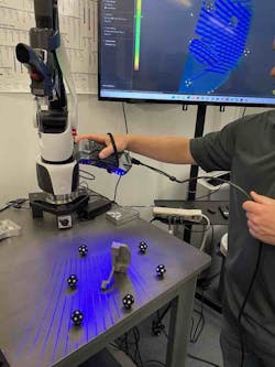

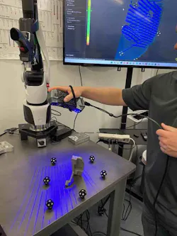

After the casting was printed, it was reverse-engineered with model-based inspection and measurement software, which included tools to scan the casting to create a solid model. Next, an exact replica of the casting was produced. The model used for reverse engineering was then uploaded to the CAD/CAM system to help create the soft jaws. 3D printing software and a printer capable of printing carbon PEEK were used.

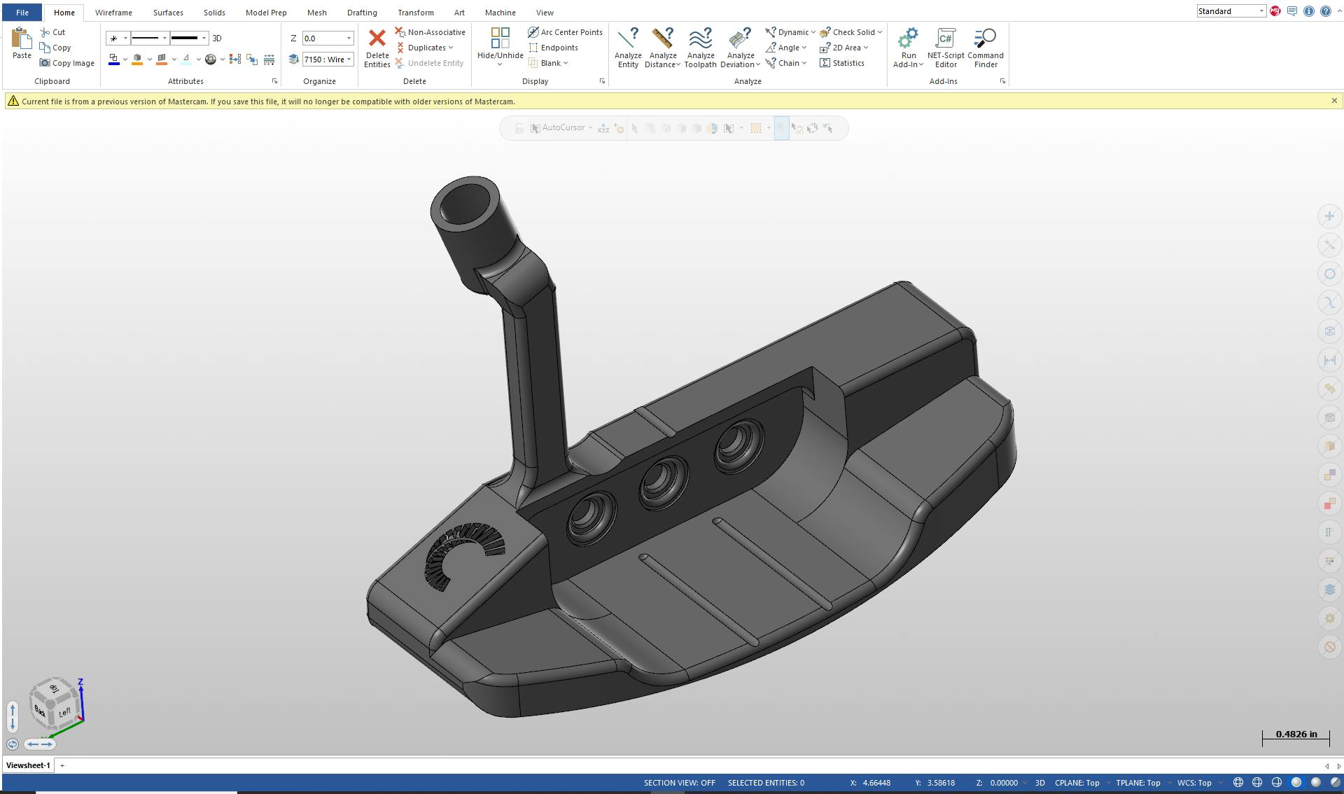

The third article will dive into the nucleus of the project: CAD/CAM software. Design for manufacturing and simulation will be examined as well. Every step of the closed-loop manufacturing process was programmed within CAD/CAM software, including programing the fixture from the solid part. The only time the designer left the CAD/CAM software was to hit “go” on the 3D printer. Other than that, everything was tied into CAD/CAM.

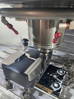

Once the 3D-printed model was created, the part location was written using probing software, which automatically generated G-code and inserted it into the NC program. For the machining program, simple mill operations programmed with CAD/CAM cut the part and a contour toolpath created a smooth finish.
While the casting was being machined, in-process inspection probes updated toolpaths as needed and the part was verified within CAD/CAM. In addition, verification software was used to create an exact digital twin of the CNC machine. The operator no longer had to run a dry cycle to make sure that the tool wouldn’t collide with the part.

After back plotting, simulating and verifying the part, CAM toolpaths were selected. The casting was easily moved and manipulated thanks to the design of the 3D-printed soft jaws. The jaws were built with multiple stations and could be moved between four separate locations for machining specific features. Each feature was located by a probe mounted on the mill.

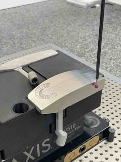

The last step of the closed-loop process was to inspect the finished part on a coordinate measuring machine (CMM). This step relied on inspection software, which was programmed within the CAD/CAM program. To conserve machine time, the same soft jaws used to hold the casting during machining were used to hold it during the CMM inspection. By not having to create additional fixturing for the CMM, significant amounts of time and money were saved.
