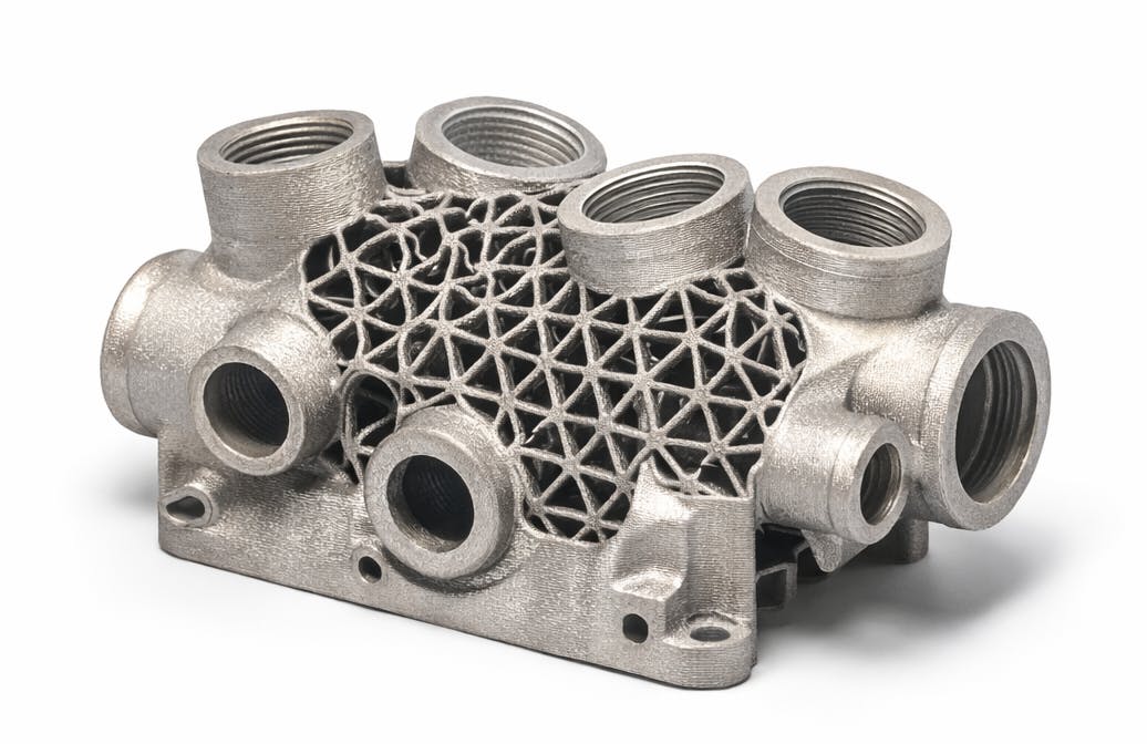

Additive manufacturing creates internal channels, lattice structures and complex geometries impossible with traditional machining or molding. Engineers can consolidate multiple components into single, higher-performing designs.
But production demands throughput. Build time depends on layer-by-layer deposition and doesn’t compress with scale. Unlike conventional processes, where cycle time decreases through improved tooling or parallel operations, additive throughput stays relatively fixed for any given part and process. More printers increase output, but require additional capital, floor space and staffing.
Overlooking this tradeoff turns geometrically optimal designs into production bottlenecks. A part that justifies additive manufacturing at low volumes may become too slow or expensive when demand rises. The design still works, but the printing process no longer delivers the required output, cost or lead time.
Consider a manifold redesigned for additive manufacturing. Consolidating multiple drilled passages into one printed structure reduces assembly steps and potential leak paths. The same design may increase build time and constrain throughput compared to machined alternatives at higher volumes.
If geometric complexity does not eliminate enough parts, assembly steps or failure points to offset slower production, additive becomes a throughput constraint rather than an advantage.
