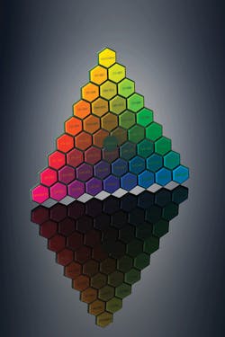

Stratasys’ Polyjet printer can build parts out of different blends of three materials, letting it create parts with a range of different colors.

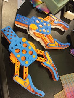

A grabber printed fully assembled in multiple colors. (Credit: Curtis Ellzey)

Polyjet lets materials be blended for a larger palate of colors and wider range in properties. This reduces processing time for 3D printed parts, as the operation does not need to stop to change materials. Parts no longer need to be printed separately and assembled. This can also reduce or eliminate post-processing steps such as painting.

Developing parts so living hinges and springs can be printed into parts reduces the number of parts in an assembly, saving more time and money. Companies are also starting to print full assemblies, made possible by the way the layout of the part is designed. If the assembly needs to be dynamic a dissolvable polymer can separate the parts during the print and be removed in a finishing process.
