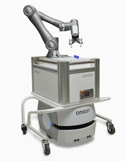

This demo was at PACK Expo 2019. Omron’s autonomous driving robot with its collaborative robot (cobot) is another trend. A cobot on an autonomous mobile robot adds extra value with abilities to load and unload resources, not to mention the possibility starting, stopping, loading, and unloading machines.
