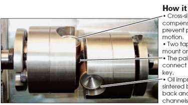

Couplings transmit power perfectly — when shafts are perfectly aligned. Flawed installations cause parallel and angular offsets leading to vibration and fatigue
Couplings transmit power perfectly — when shafts are perfectly aligned. Flawed installations cause parallel and angular offsets leading to vibration and fatigue, not to mention preload stresses and drivelinebearing friction wear. That’s why most couplings today buffer at least some misalignment. But now there is a coupling that is especially forgiving of installation inaccuracies, without using a looser fit. Compared to similarly sized couplings, this design doubles angular-offset capabilities and increases parallel-offset capabilities tenfold.
