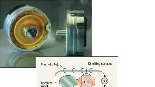

A new type of feedback device employing an inductive scanning mechanism rivals low-end absolute encoders in terms of performance, and resolvers in terms of price
A new type of feedback device employing an inductive scanning mechanism rivals low-end absolute encoders in terms of performance, and resolvers in terms of price. The stationary sensing element consists of an excitation coil and several smaller receiving coils symmetrically positioned within. All the coils reside on the inner surface of a cylindrically shaped printed circuit board. The moving element, a series of conductive surfaces on a PC board fixed to a rotating shaft, varies the electromagnetic field that couples the excitation and receiving coils. Corresponding voltage fluctuations measured across the receiving coils indicate shaft position.
