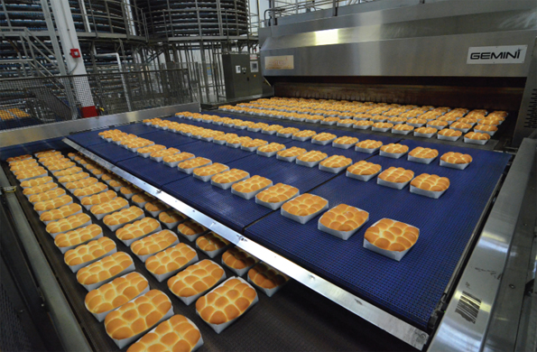

The King’s Hawaiian bread-baking process requires 11 specialized machines, manufactured by different OEMs. Using a single control architecture gave the plant advanced data-collection capabilities and simplified maintenance and upgrades.

Case in point, he says, is King’s Hawaiian, a Torrance, Calif.-based supplier of specialty breads and baked goods. They recently opened a production facility in Oakwood, Ga., that includes advanced data-collection capabilities. The goal is to maintain product quality while improving operating efficiency across the plant.
To gain these features, the control architecture was built around a common infrastructure. Bread baking, for example, requires 11 different machines built by different OEMs. But each uses Allen-Bradley ControlLogix programmable automation controllers and Factory Talk View Site visualization and information software. Packaging machines run CompactLogix PACs, which provide the features of Logix control in a smaller unit.
The entire plant communicates via EtherNet/IP, letting the company collect and store information like oven temperatures, bakes times, scale weights, and maintenance operations.
For King’s Hawaiian, the approach offers several advantages. For one, it helped get the facility up and running in only 10 months from the start of construction. Common hardware and software across varying equipment simplifies application development and training, and makes it easier to manage changes or upgrades. Technicians use the same software to address different issues throughout the plant.
