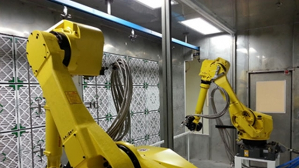

CO₂ is also finding use as a cleaning agent. In the automotive industry, several major car makers have found that CO₂ cleaning saves them money and time while lowering their negative impact on the environment.
CO₂ is used for pretreatment of plastics; it can clean parts such as automotive trim, door handles, dashboards, and headlights, prior to a painting or coating. CO₂ spray effectively removes all contaminants that may affect the quality of the paint, such as light oils, water marks, dusts, and fingerprints.
CO₂ spray cleaning systems are integrated directly into the manufacturing line. The parts heading for the entrance to the painting booth are cleaned with the help of two robots that work simultaneously to remove all the foreign objects on the surface.
CO₂ spray is delivered at pressures high enough to clean parts effectively, but low enough not to damage parts’ surfaces. Unlike traditional cleaning processes, CO₂ evaporates completely, leaving no residue to necessitate a second cleaning. It also cleans without condensation, so there is no need for cleaning zones in most plants. After cleaning with dry CO₂, parts can move directly into painting/coating, saving energy and time associated with expensive drying processes.

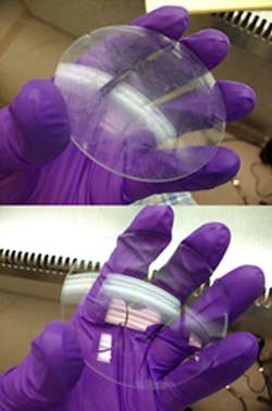

Similar to pretreatment plastics cleaning, CO₂ cleans optic lenses of water spots and light particulate without damaging the surface. Other industries include, but not limited to electronics, semiconductor, medical, and aerospace.
