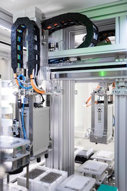

Pipettes about to enter the DNA samples.

Side-by-side 96 well disposable tip aspirate/dispense heads are used for adding beads and binding buffer to the samples in the first step of the process, as well as doing the final quick wash and elution at the last step of the process.
