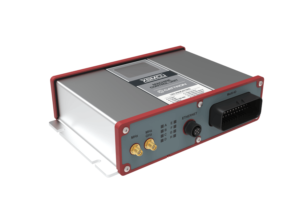

The unit’s primary innovation lies in its ability to support wireless control and monitoring using safe, encrypted RF communication combined with diverse serial communication support. The XBMCU eliminates the need for traditional cabling historically required to bring valuable data and critical controls to end users, reducing both upfront setup costs and long-term maintenance requirements.

The XBMCU features dual CANbus interfaces supporting a comprehensive range of protocols including J1939, CAN FD, CANopen and CANopen Safety. The unit is also lab-certified for PROFINET communications with Class C Conformance for reliable, real-time data handling.
For North American manufacturers, the XBMCU will support Ethernet IP protocol, with plans to incorporate CIP Safety and PROFIsafe (currently under certification), providing a comprehensive solution that eliminates the need for multiple products from different manufacturers.

The XBMCU champions complex operations with an extremely simple hardware interface. Serial communication setup is as easy as connecting a PLC to the D-Coded M12 connector. For safe protocols such as CANopen Safety, CIP Safety and PROFIsafe, users only need to add a power supply and their machine is ready to go.

The XBMCU’s rugged IP66-rated aluminum enclosure enables deployment in demanding industrial settings. It features a wide range 9-36 VDC supply, eight digital inputs configurable for Category 3 PL-d arrangements and six 3A digital outputs that can similarly be configured for enhanced safety.
The core of the XBMCU product is designed and certified PL-d per the ISO 13849 standards. Beyond the hardware, the XBMCU has achieved several certifications with lab-tested and approved PROFINET and Ethernet/IP and is in the process of TUV certification for PROFIsafe and CIP Safety.
