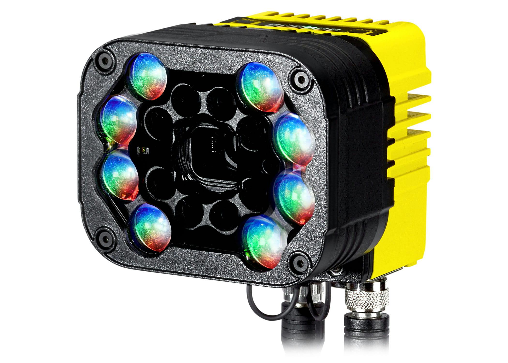

  • The In-Sight 3800 can inspect up to 1,200 parts per minute, leveraging multi-torch illumination for enhanced surface contrast.
  • Built on hybrid AI, it merges AI-based edge learning with rule-based algorithms to handle complex and variable inspection tasks efficiently.
  • Multi-spectrum imaging allows the system to project different wavelengths onto targets, revealing surface imperfections invisible under standard lighting.
The In-Sight 3800 Vision System was one of several demonstrations at the Cognex booth at Pack Expo 2025 held in Las Vegas (Sept. 29- Oct. 1, 2025).
The vision system can inspect 1,200 parts per minute while leveraging multi-torch illumination. It essentially enhances image contrast across materials and surface finishes, said Alan Lunardhi, technical sales engineer, Cognex.
Hybrid AI Enables Smarter Inspection
In-Sight 3800 is built on a hybrid AI framework and real-time processing capabilities, noted a Cognex press release. This is a welcome feature for engineers advancing inspection, part tracking and robotic guidance in digitally connected manufacturing environments.
At the system’s core is an embedded suite of inspection tools that merges AI-based edge learning with rule-based vision algorithms. Cognex has transitioned from traditional rule-based inspection methods to example-based learning in this system. This is a form of built-in AI that enables the system to handle more complex or variable inspection tasks, Lunardhi explained.

At the packaging and processing show, the platform was set up to verify blue label alignment and bottle cap presence on medical vials. Lunardhi pointed out how the changing appearance of the caps in a monochrome display illuminated the system’s use of multi-torch illumination. The technique sequentially projects red, green, blue, white and infrared light onto the target. By capturing the images under each wavelength, the system enhances contrast and shows surface characteristics or imperfections that are undetectable or invisible when using standard lighting conditions.
READ MORE: Currency Inspection Demonstration Using High-fidelity 3D Profile Sensor
The multi-spectrum approach is valuable for color inspections across color-sensitive or material-dependent applications (including medical packaging and food and beverage containers) where consistent detection is essential. Having this flexibility in one integrated vision device expands inspection flexibility and performance for diverse use cases, including cap alignment, label verification and surface analysis, Lunardhi said.
The In-Sight 3800 Vision System is intended for various tasks, such as detecting defects, monitoring production lines, guiding assembly robots and tracking, sorting and identifying parts.
