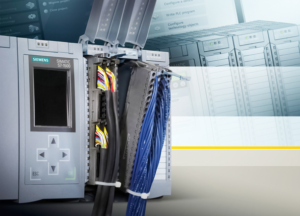

The Simatic Top connect cabling system wires Simatic S7-1500 input/output modules, eliminating time-consuming terminal block connections. The system’s modular design provides well-organized field sensor and actuator wiring. It includes plug-in front-connector modules that easily attach to Simatic S7-1500 I/O modules and preassembled connecting cables.
A flexible model for simple wiring inside the control cabinet and LED signaling and signal conditioning from 230 Vac to 24-Vdc options are also available. With a 0.5-sq-mm cross section, individual wires handle higher currents and come in different lengths and versions: H05V-K single wires (PVC insulation) and H05Z-K (halogen-free insulation) for applications not requiring UL or with UL/CSA certified single wires.Siemens Corp., 300 New Jersey Ave., Suite 1000, Washington, DC 20001, (800) 743-6367, www.industry.usa.siemens.com/automation/us/en/automation-systems/system-cabling/simatic-top-connect/Pages/Default.aspx?stc=usiia100019&sp_source=usiia100019
